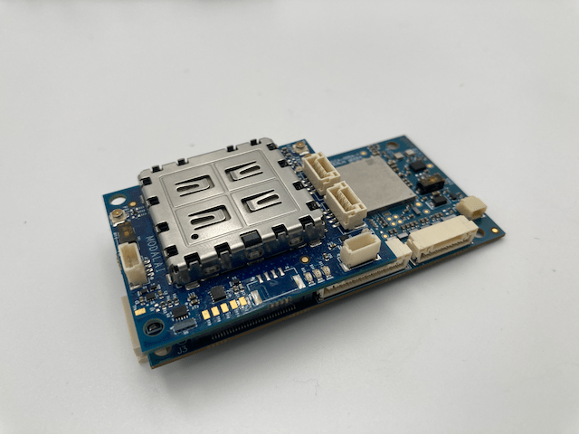

VOXL 2 power and USB connections for setup
  • Connect power cable to VOXL 2 J4 (5V input, but use Power Module or ESC)
  • Connect other side of power cable to Power Module
  • Connect USBC cable to VOXL 2 J9
  • Connect other side of USBC cable (recommended USB type A) to host computer
  • Connect Power Module to the wall wart power supply
  • Plug wall wart power supply into mains supply
Three LEDs should illuminate GREEN (LED details found here).
