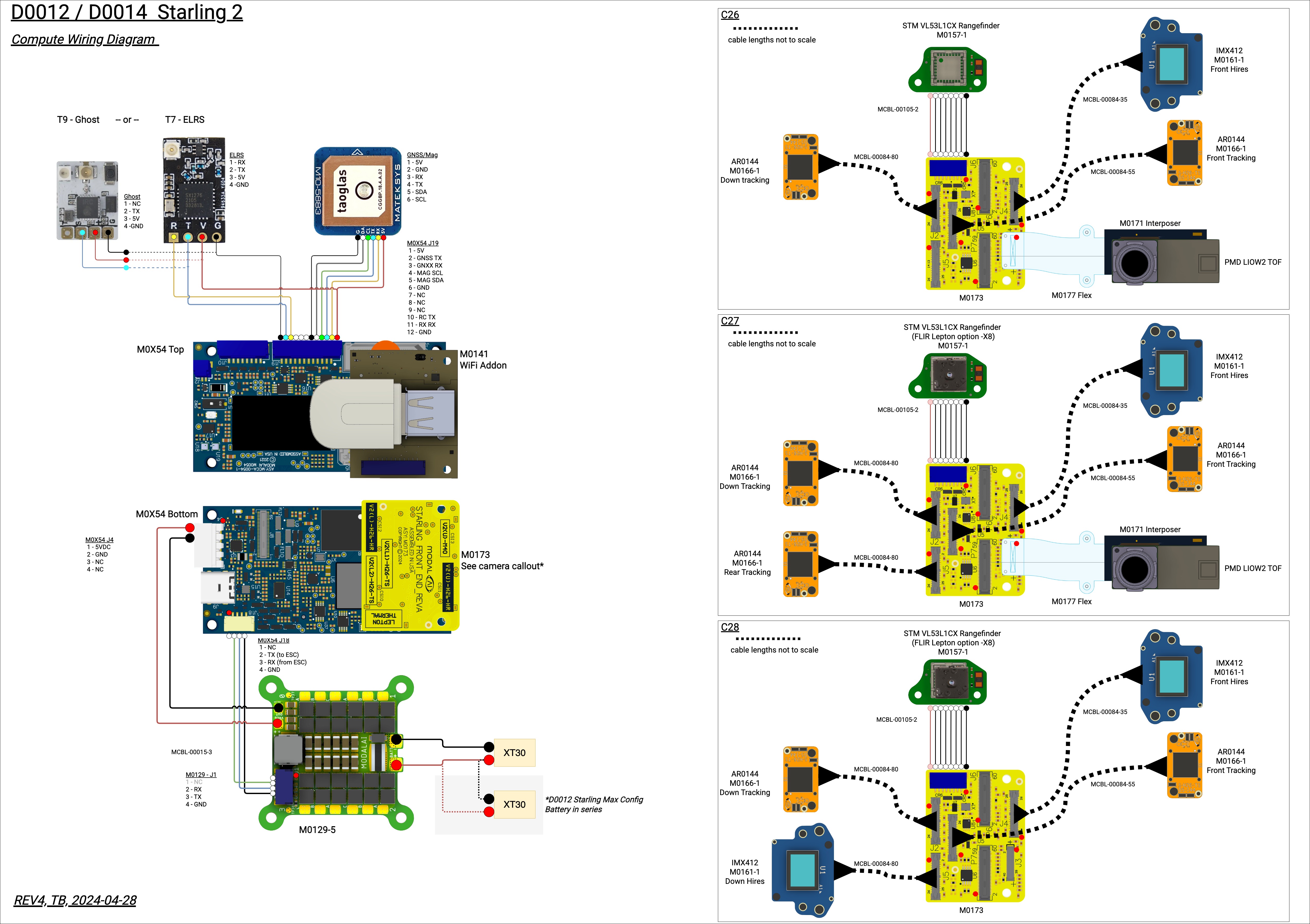

Block Diagram
Below describes the compute HW block diagram for the D0014-4-CXX-M22-TX configuration.
CWD-D0014-4-CXX-M22-TX View in fullsize
Diagram draw.io Source
Additional camera configs:
VOXL2 - D0012-4-CXX-M22-TX
The Starling 2 Max D0012-4-CXX-M22-TX configuration consists of:
  • D0012-4 - Starling 2 Family
    • VOXL ESC Mini with built in power management
    • 180mm Tri-Blade Propellers, 2203.5 Brushless Motors, Dual 2S battery
  • CXX
    • C28 - Dual AR0144, Dual IMX412
  • M22 - WiFi modem config
  • TX
    • T7 - ELRS
    • T9 - Ghost
Block Diagram
See above
