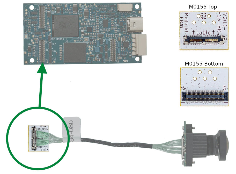

The M0155 connects one DF-56 micro-coax image sensor module to a VOXL 2 or VOXL 2 Mini camera group. Micro-coax lets the sensor sit anywhere on the airframe, at any orientation, with only a thin coax run back to the compute board, instead of the short flex cables that earlier modules used.

VOXL 2 side
Mates with VOXL 2 or VOXL 2 Mini camera group connectors J6, J7, or J8.
Sensor side
One DF-56 micro-coax connector. Mates with any ModalAI micro-coax sensor module through an MCBL-00084 cable: M0161, M0166, M0186, and similar.
