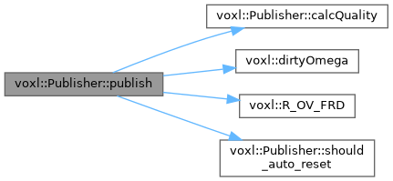

◆ publish()
void Publisher::publish ( std::shared_ptr< ov_msckf::State >  state,
const std::map< double, std::vector< std::shared_ptr< ov_core::Feature > > > &  used_features_map = {}
Publish VIO data.
Publish VIO data to external systems.
Publishes the current VIO state and tracking information to external systems through the configured pipe interfaces.
Parameters
stateCurrent VIO state
used_features_mapUsed-features map, by reference (no copy). The caller runs on the VIO thread synchronously after the update, so the reference stays valid for the whole call; publish must never re-enter feed/drain.
This method formats and publishes the current VIO state and tracking information to external systems through the configured pipe interfaces.
The function performs the following operations:
  • Formats VIO data packet with current state information
  • Performs coordinate frame transformations (OpenVINS to FRD)
  • Calculates angular velocity from quaternion differences
  • Extracts and formats covariance matrices
  • Handles camera-to-IMU extrinsic parameters
  • Publishes both simple and extended VIO data packets
The coordinate frame transformation involves:
  • Converting from OpenVINS coordinate frame to Front-Right-Down (FRD)
  • Handling initialization state with NED rotation zeroing
  • Applying proper quaternion and rotation matrix transformations
Parameters
stateCurrent VIO state containing pose, velocity, and covariance
Definition at line 151 of file VoxlPublisher.cpp.
References alt_z, auto_reset_max_v_cov_timeout_s, auto_reset_max_velocity, auto_reset_min_feature_timeout_s, auto_reset_min_features, calcQuality(), voxl::dirtyOmega(), en_debug, EXTENDED_CH, fast_yaw_thresh, fast_yaw_timeout_s, frame_transform, has_acc_jerk, is_resetting, non_static, ok_state_grace_timeout_s, quality_bad_to_good_count, quality_good_to_bad_count, quality_high_thresh, quality_initial_to_bad_count, quality_initial_to_good_count, quality_low_thresh_good, quality_low_thresh_initial, voxl::R_OV_FRD(), reset_num_counter, reset_requested, should_auto_reset(), SIMPLE_CH, vio_error_codes, vio_manager, and vio_state.
Referenced by voxl::register_vio_camera_callback().
Here is the call graph for this function:
Here is the caller graph for this function:

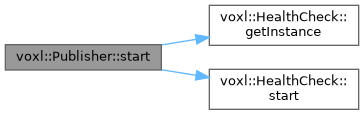

◆ start()
void Publisher::start ( )
Start the publisher.
Initializes the publisher and prepares it for data transmission.
Initializes the publisher and prepares it for data transmission. Sets the first_packet flag to true to handle the initial angular velocity calculation.
Definition at line 53 of file VoxlPublisher.cpp.
References voxl::HealthCheck::getInstance(), voxl::HealthCheck::start(), and vio_state.
Referenced by main().

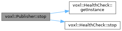

◆ stop()
void Publisher::stop ( )
Stop the publisher.
Stops the publisher and cleans up resources.
Stops the publisher and cleans up resources. Currently a placeholder for future cleanup operations.
Definition at line 71 of file VoxlPublisher.cpp.
References voxl::HealthCheck::getInstance(), and voxl::HealthCheck::stop().
