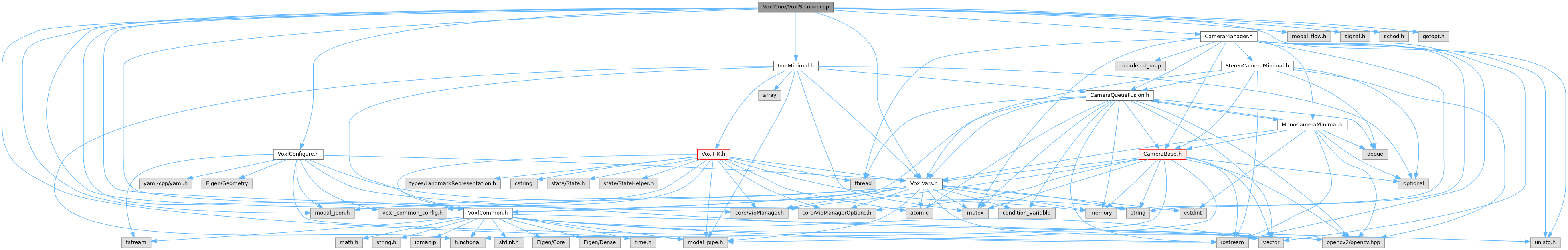

Include dependency graph for VoxlSpinner.cpp:

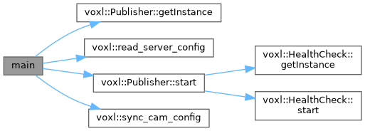

Here is the call graph for this function:
