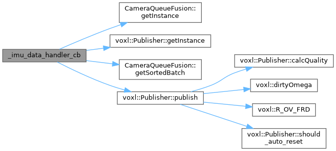

◆ _imu_data_handler_cb()
void _imu_data_handler_cb ( int  ch,
char *  data,
int  bytes,
void *  context
Handler for incoming IMU data.
This callback processes incoming IMU data, updates the system state, and triggers appropriate processing based on motion state. It serves as the primary entry point for all IMU data processing in the system.
The function performs the following operations:
  • Validates and parses IMU data packets
  • Updates frame transformation based on gravity direction
  • Converts IMU data to OpenVINS format
  • Performs batch processing to reduce mutex operations
  • Feeds IMU data to the VIO manager
  • Synchronizes camera data with IMU timestamps
  • Triggers VIO processing and data publishing
The function uses batch processing to minimize mutex contention at high IMU frequencies and ensures proper temporal synchronization between IMU and camera data.
Parameters
chChannel number (unused)
dataPointer to IMU data buffer
bytesSize of data buffer in bytes
contextContext pointer (unused)
Definition at line 54 of file ImuMinimal.cpp.
References active_callbacks, en_debug, frame_transform, imu_model, is_imu_connected, is_resetting, last_imu_timestamp_ns, reset_cv, reset_mtx, vio_error_codes, and vio_manager.
Referenced by connect_imu_service().
Here is the caller graph for this function:

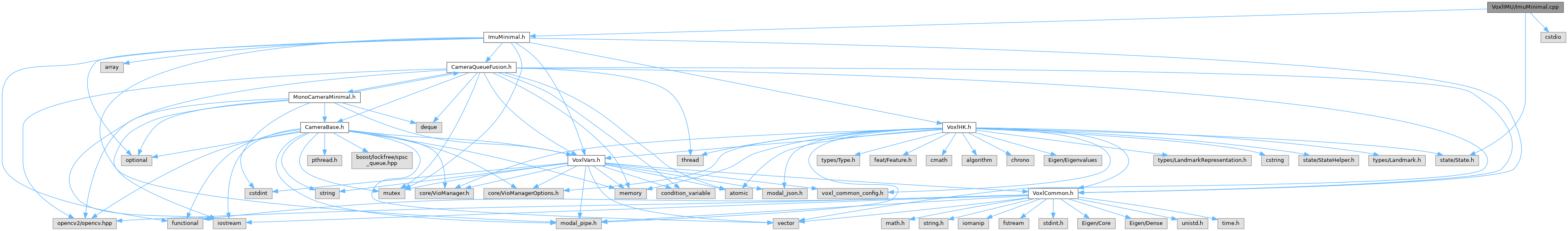

◆ _imu_disconnect_cb()
void _imu_disconnect_cb ( __attribute__((unused)) int  ch,
__attribute__((unused)) void *  context
Callback for IMU disconnect events.
This function is called when the IMU service disconnects. It handles the cleanup and state management required when IMU data becomes unavailable.
The function uses thread-safe mutex locking to ensure proper state management during disconnection events.
Parameters
Definition at line 157 of file ImuMinimal.cpp.
References IMU_CH, imu_lock_mutex, and is_imu_connected.

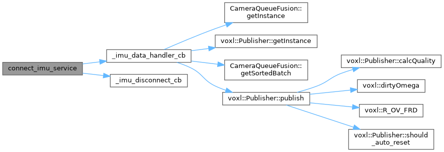

◆ connect_imu_service()
int connect_imu_service ( void  )
Creates IMU pipe client and associated callbacks.
This function sets up the disconnect and data handler callbacks, and opens the client pipe connection to the IMU service. It initializes the complete IMU data pipeline for the VIO system.
  • Sets up disconnect callback for graceful handling of service disconnection
  • Sets up data handler callback for processing incoming IMU measurements
  • Configures thread priority for high-frequency IMU processing
  • Opens the client pipe connection to the IMU service
  • Configures the pipe for optimal data flow
  • Sets the IMU connection status flag
Returns
0 on success, -1 on failure
Definition at line 188 of file ImuMinimal.cpp.
References _imu_data_handler_cb(), _imu_disconnect_cb(), IMU_CH, imu_name, is_imu_connected, PROCESS_NAME, and vio_error_codes.
Here is the call graph for this function:
