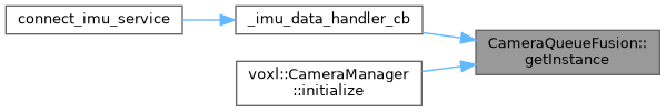

Referenced by _imu_data_handler_cb(), and voxl::CameraManager::initialize().
Here is the caller graph for this function:
